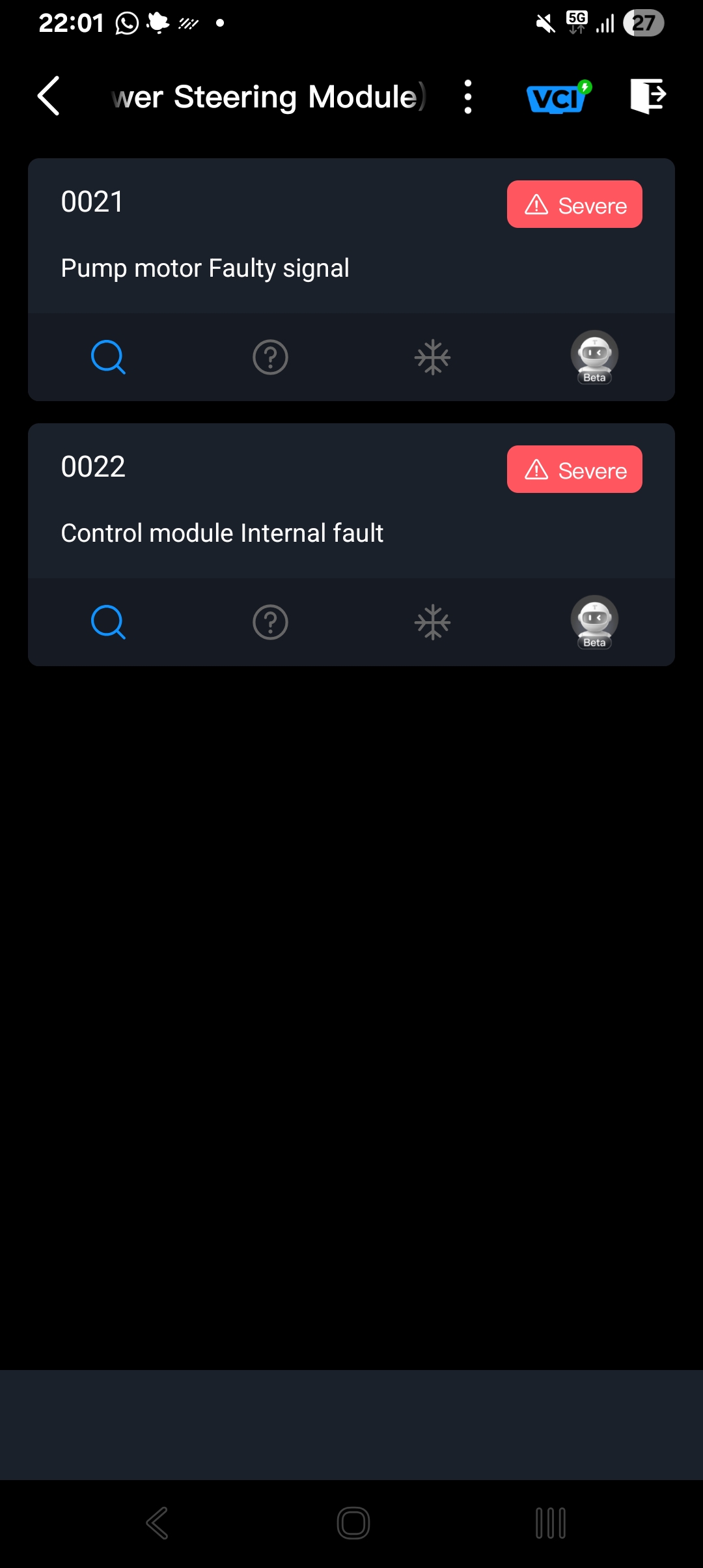

The next morning, I got a "Power Steering Service Required" error message on the dash, and the power steering had failed completely—I could only steer with a lot of effort. Interestingly, the whining noise was gone. I read the fault codes from the power steering pump's control unit, which I will attach.

Thanks very much for your reply - The pump doesn't make any noises anymore, it did as described in my initial post, after it died it did not make any noises, not when starting the car and not when turning the wheel.. I do wonder if something electronic inside the pump died hence the error codes I attached..if a bearing is shot like in the video, you would probably at least hear something..
